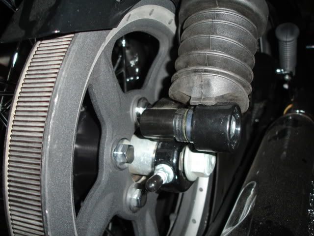

    pics of lowering blocks installed

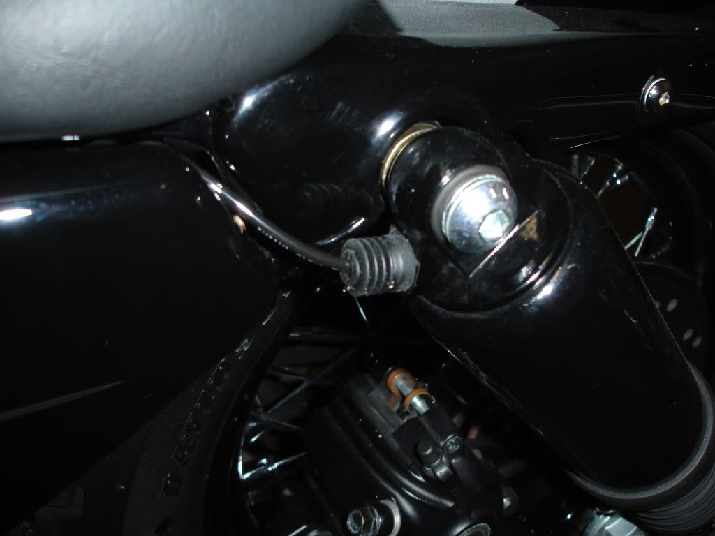

    heres a pic gators i found to cover brass air valves..i know they look big but it just a close up. try to find them in the other pics
    i now a pic of the bike without the gators on the valves..they stick out like a sore thumb..imo

                  anything ya need to know just ask ive done it once and im sure ill do it again if not for me one of my buddies..
