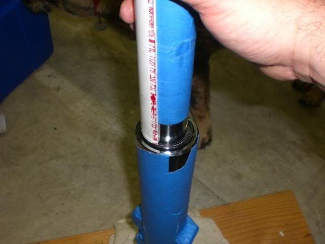

            I know it's a little late but I used the PVC method too. I used a piece of schedule 40 PVC (thicker) cut in half to drive in my seals. I tap them in with the PVC and a dead blow hammer. Its always worked like a champ. Here's a few pics for you.

              PVC for me also. Plus I use the old seal to sit on top of the new one so it does not get damaged. JMO
