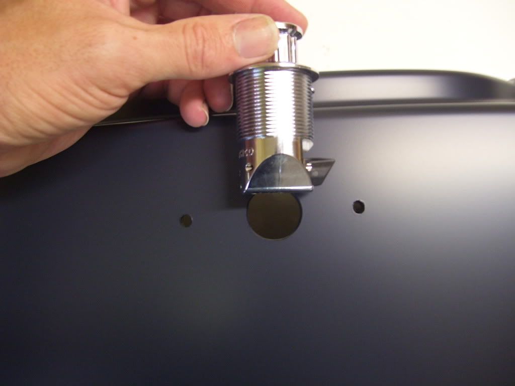

                  ok, before I could start on the paint process for the bag caps, I had to modify them slightly, Bigun has chosen to replace the hockey puck style latch handles with a slim pop-up style from Diablo Custom Baggers.
                  the mounting hole needed to be bigger so I wanted to do the "cutting" before prepping for paint

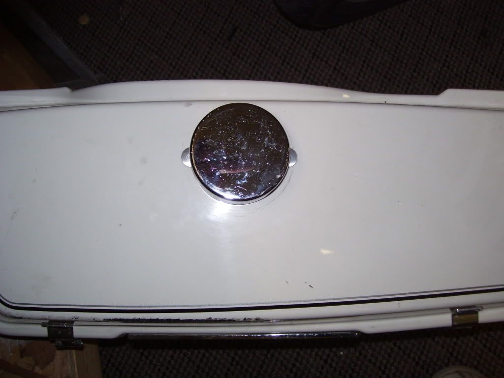

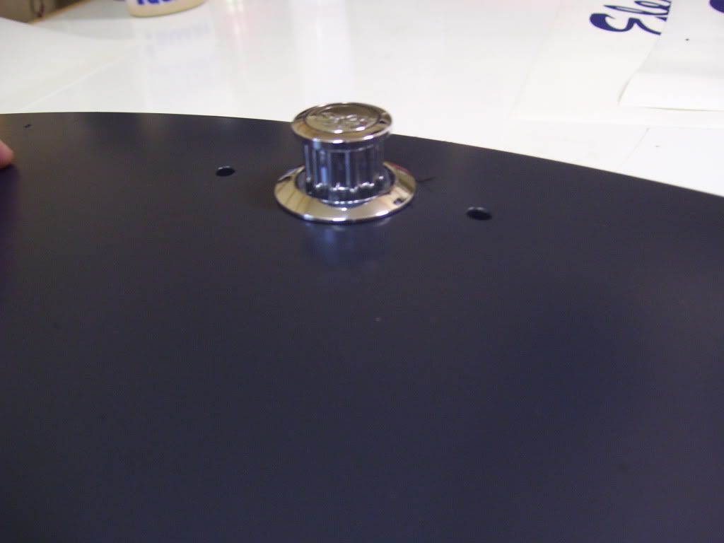

                  this is the stock style latch on the old bag cap

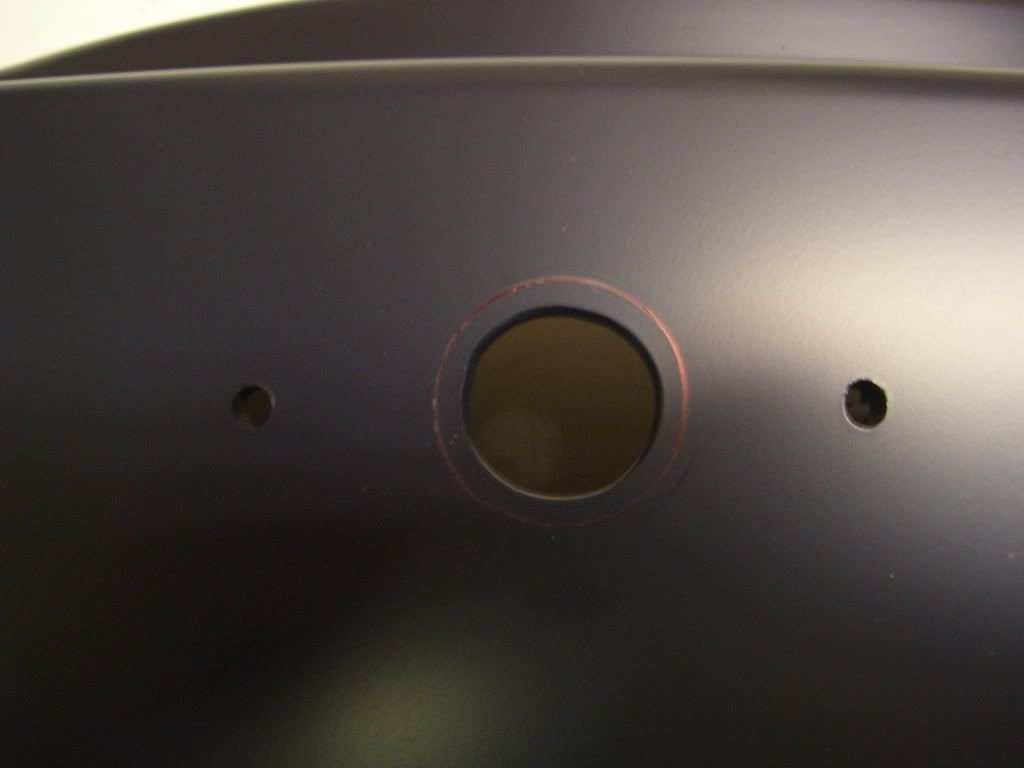

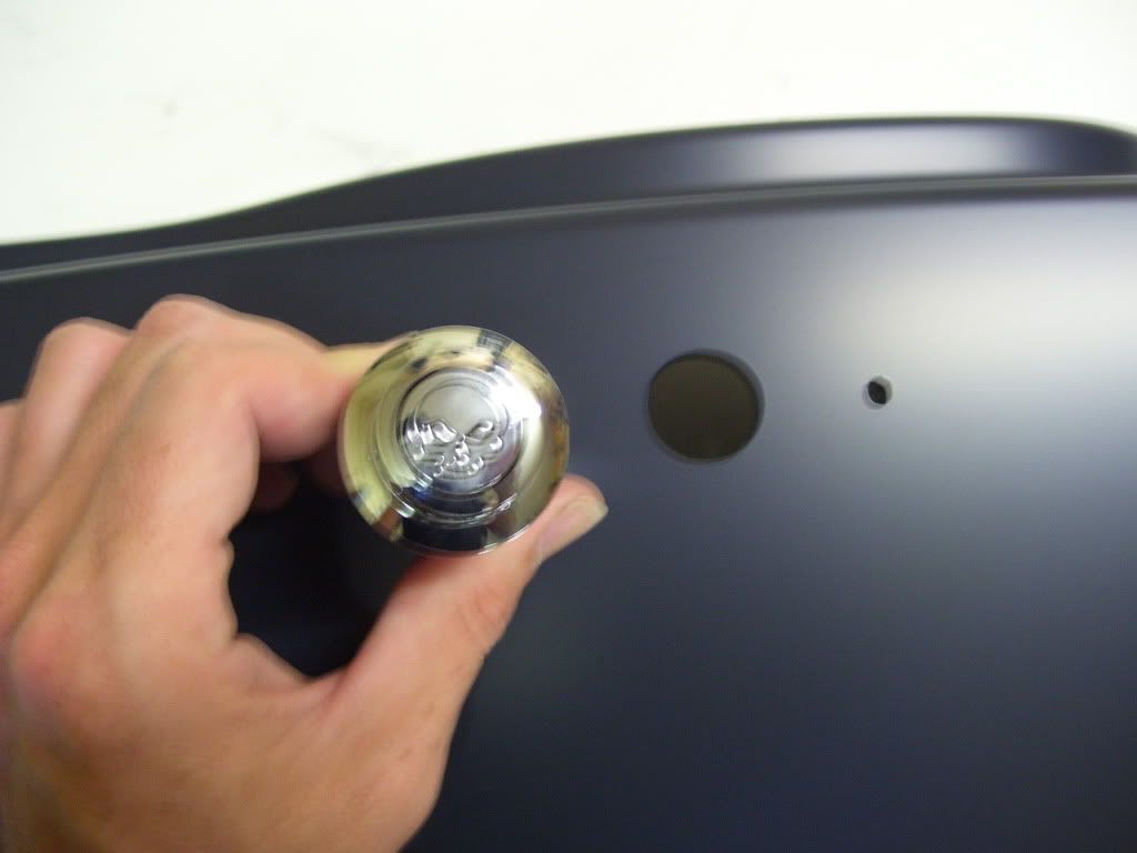

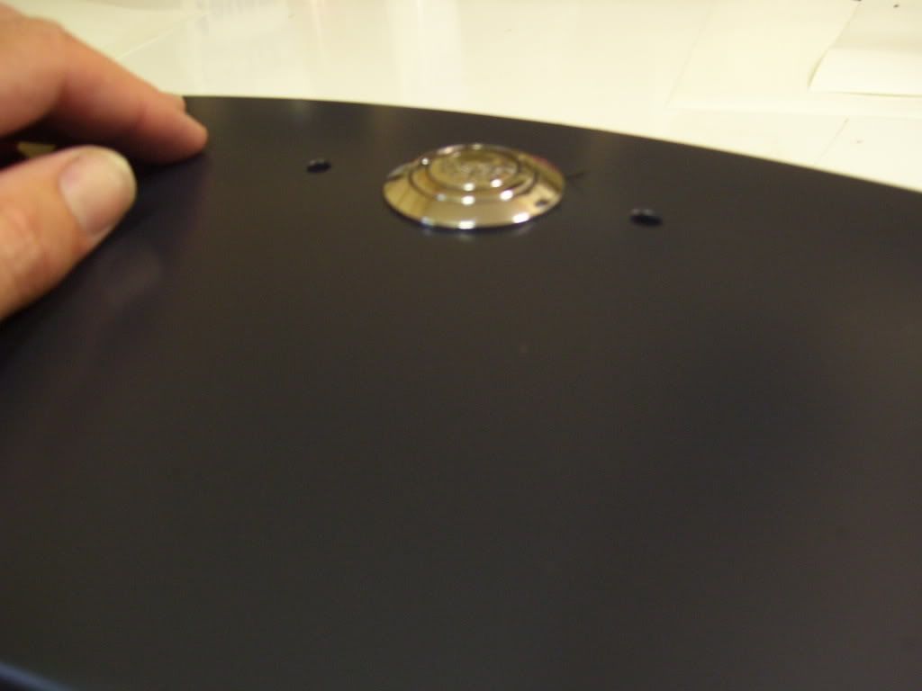

                  the next 2 pictures you can see the difference in mounting hole size

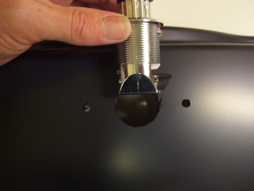

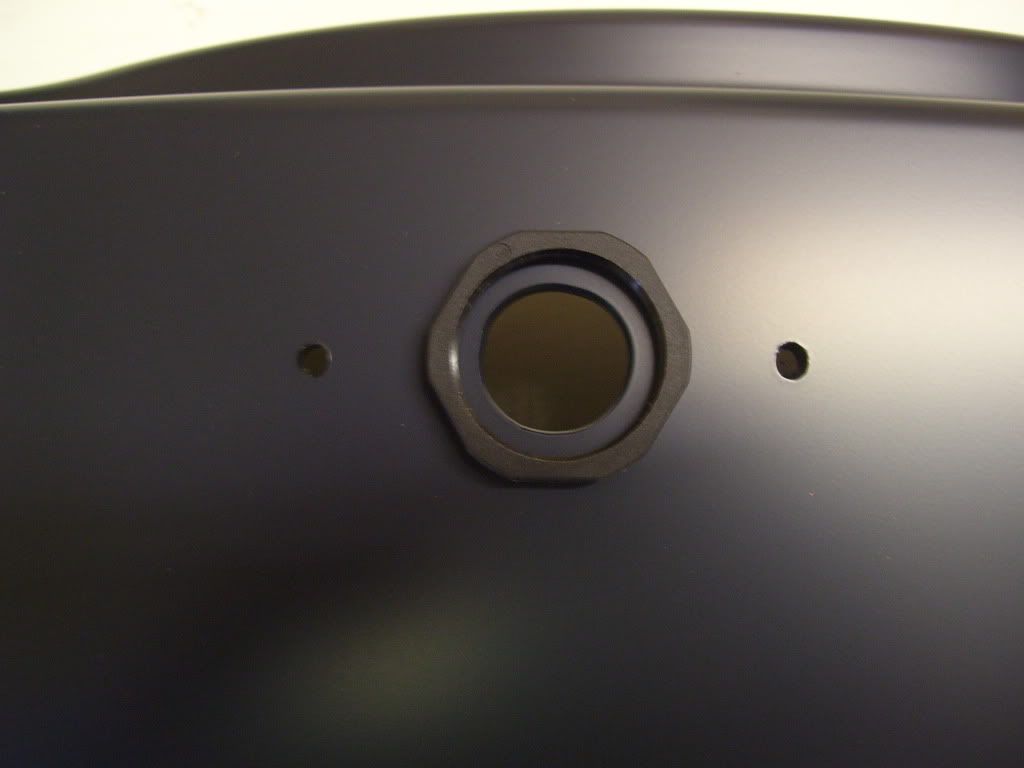

                  so , per instructions from DCB, I took the mounting nut and centered it over the original hole

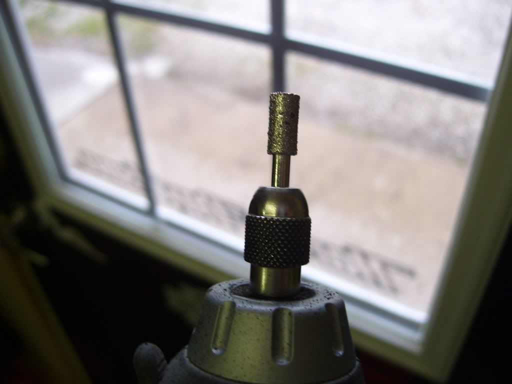

                  then used a roroty tool with a diamond deburring drum to "carve" the orinial hole just slightly bigger than the traced ring

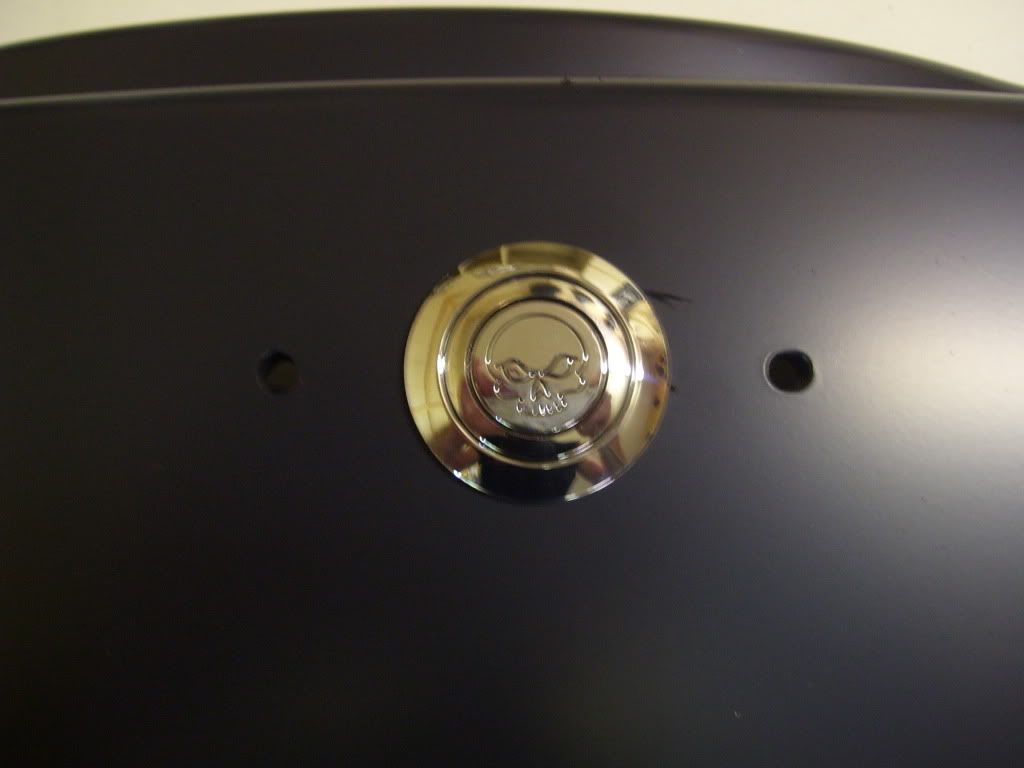

                  the new pop-up latch fit, so now I can begin prep work for paint
                  doesn't the new style look so much nicer than the old hockey puck
                    Yes it does IH , nice up-grade.
                      I like it. Definitely looks better than the old style...we need a thumbs up smiley.
