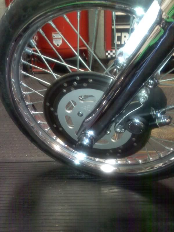

Front brake caliper bolts:

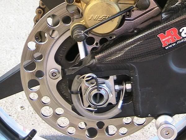

Race bike rear brake and axle:
HMMMM yea looks like I need to finally breakdown and get that torque wrench, hadnt thunk that farTHE NEGATIVE ONE no better don't click
