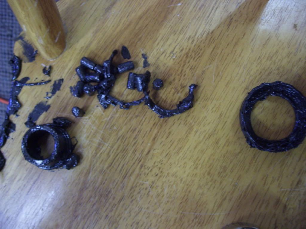

    after a bearing failure, thought I would do a step by step of how to change your bearings in your wheels
    now, for the record, Harley wheels have preload shims behind the bearings, my wheels do not.
    this is why I had to change my wheel bearings
    this is what an exploded bearing and globs of grease contaminated with parts of a bearing cage looks like

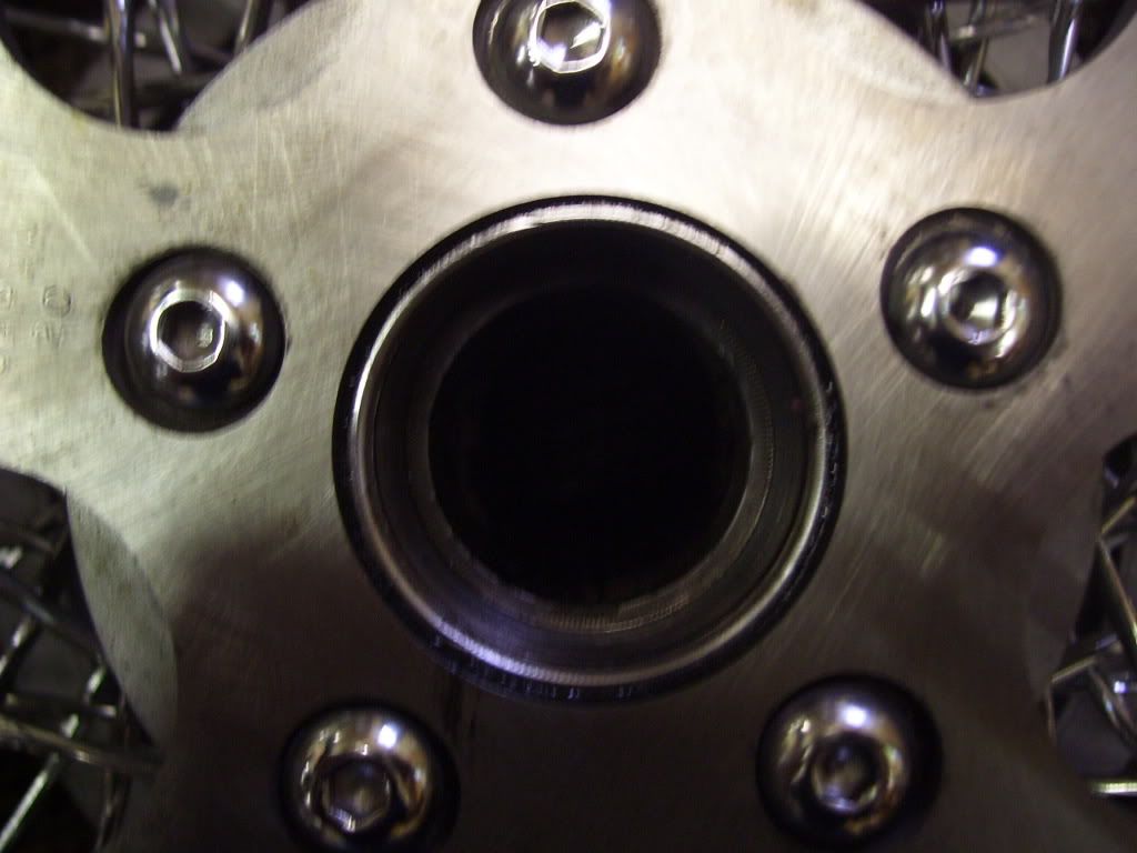

    after removing the bearings spacers and bearing races. to remove the races, we used a long punch and a hammer to drive them out

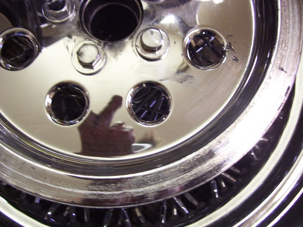

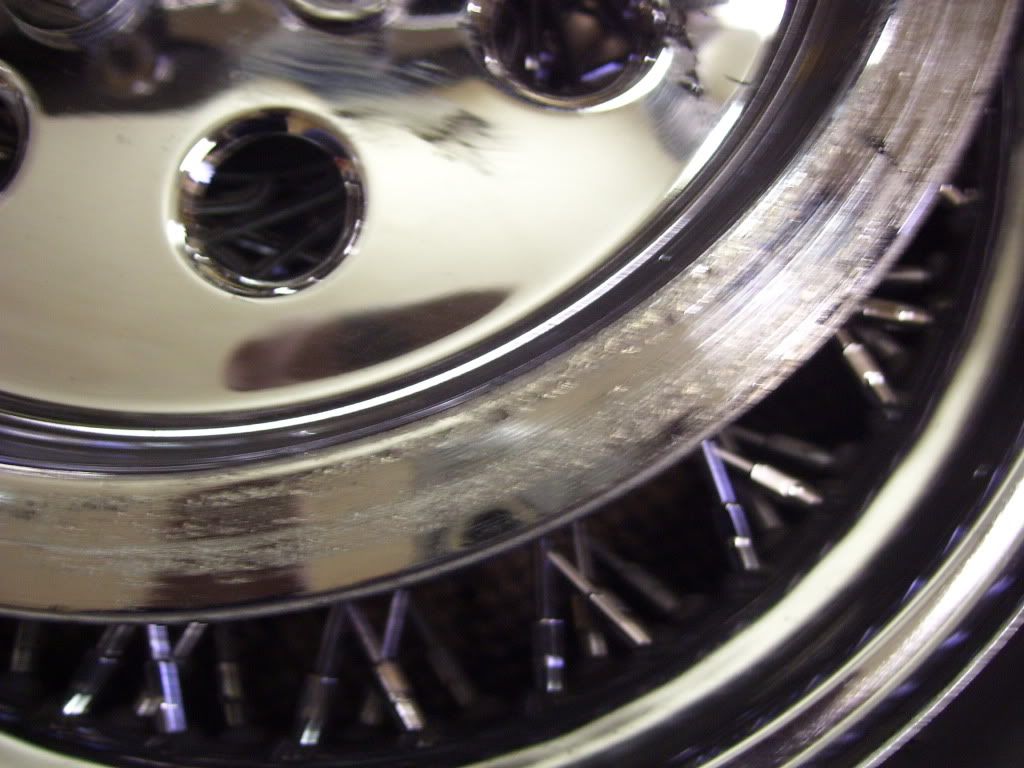

    showing the damage to my drive pulley, notice the gaulding where it was rubbing a goove into the inside of my swingarm

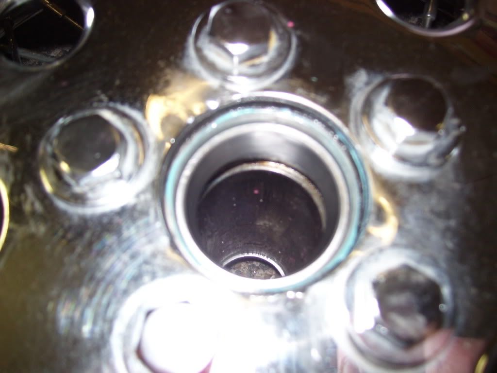

    clean all residual greas and debri from inside of the hub

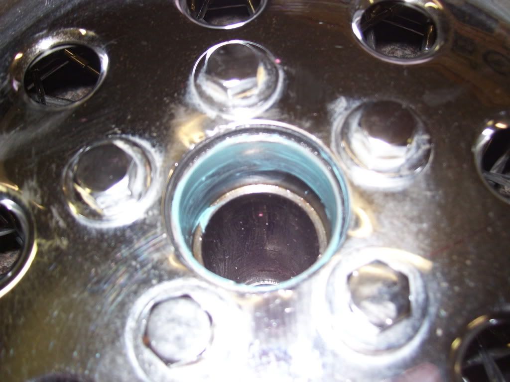

    then I smeared a thin layer of grease on the inside of the hub getting ready to install the bearing race on this side
    set new race in the hub and tap it into place, once the race was almost completely seated, I used a large socket and a heavy rubber mallet to drive it the rest of the way down

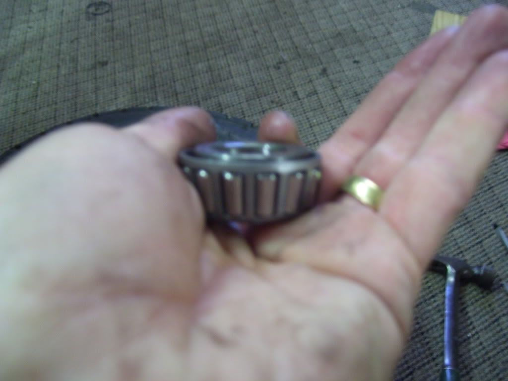

    new bearing

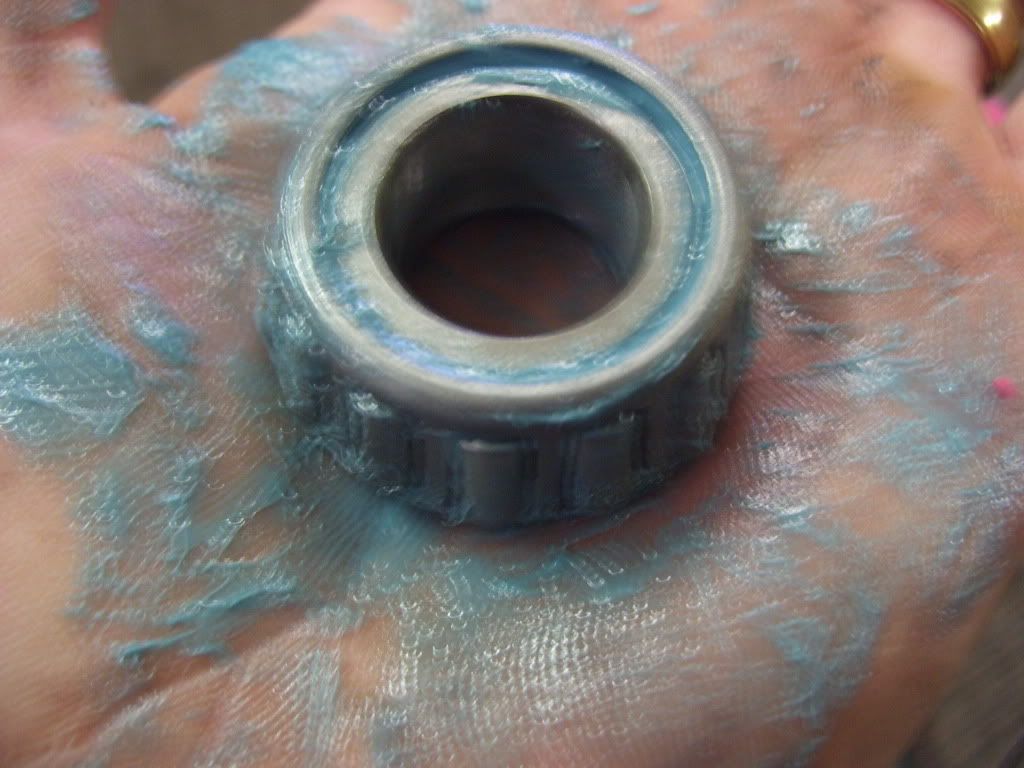

    after packing with grease, after this step, you need to clean your hands, then wipe all grease off of camera, lol

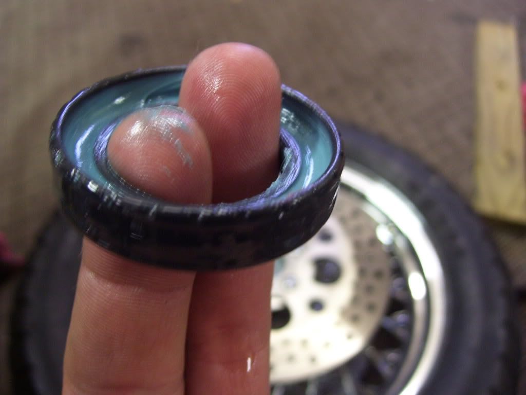

    then comes the oil seal. as per my manual for the bike, I coated the inside of the seal with grease and a thin film of oil on the outside of it

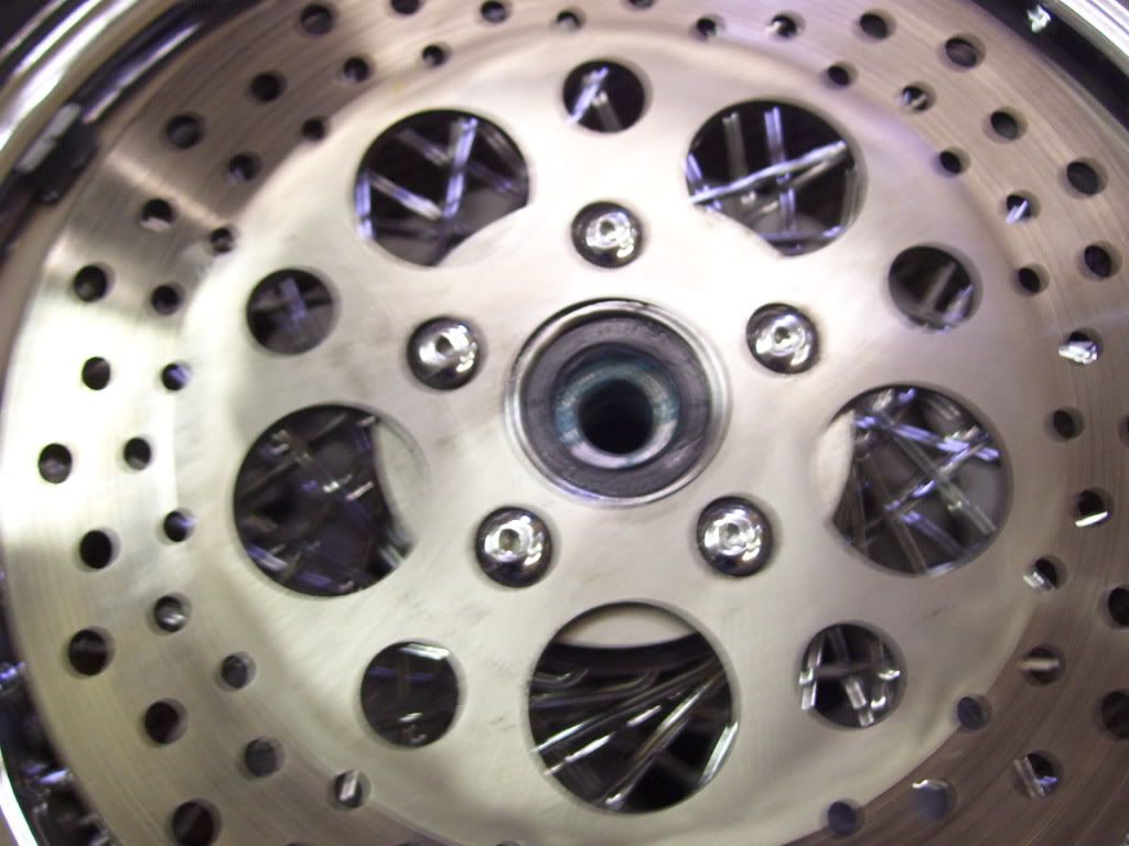

    everything installed now also, before installing the bearing and seal on the second side, you need to remember to reinstall your inner spacer

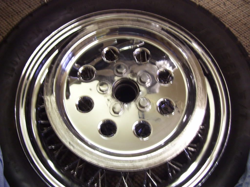

    then put your bike back together, make sure the rear wheel is centered and alligned straight so that it tracks straight and the belt stays centered in the final drive pulley.
