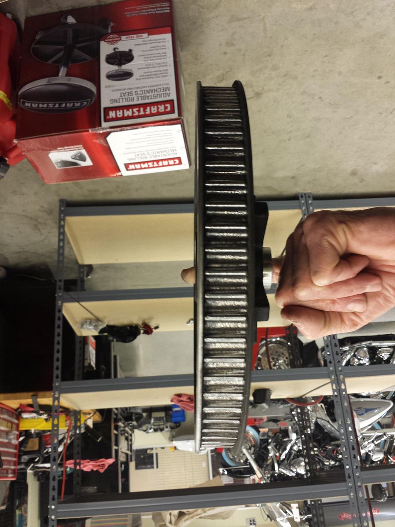

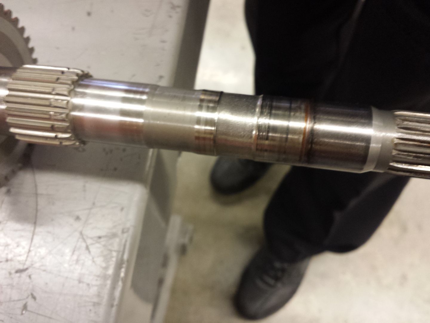

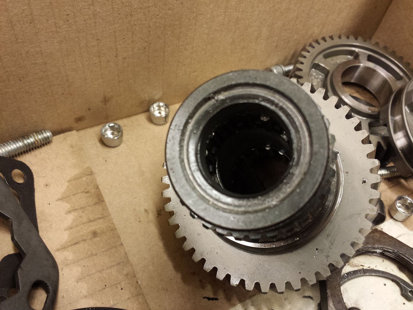

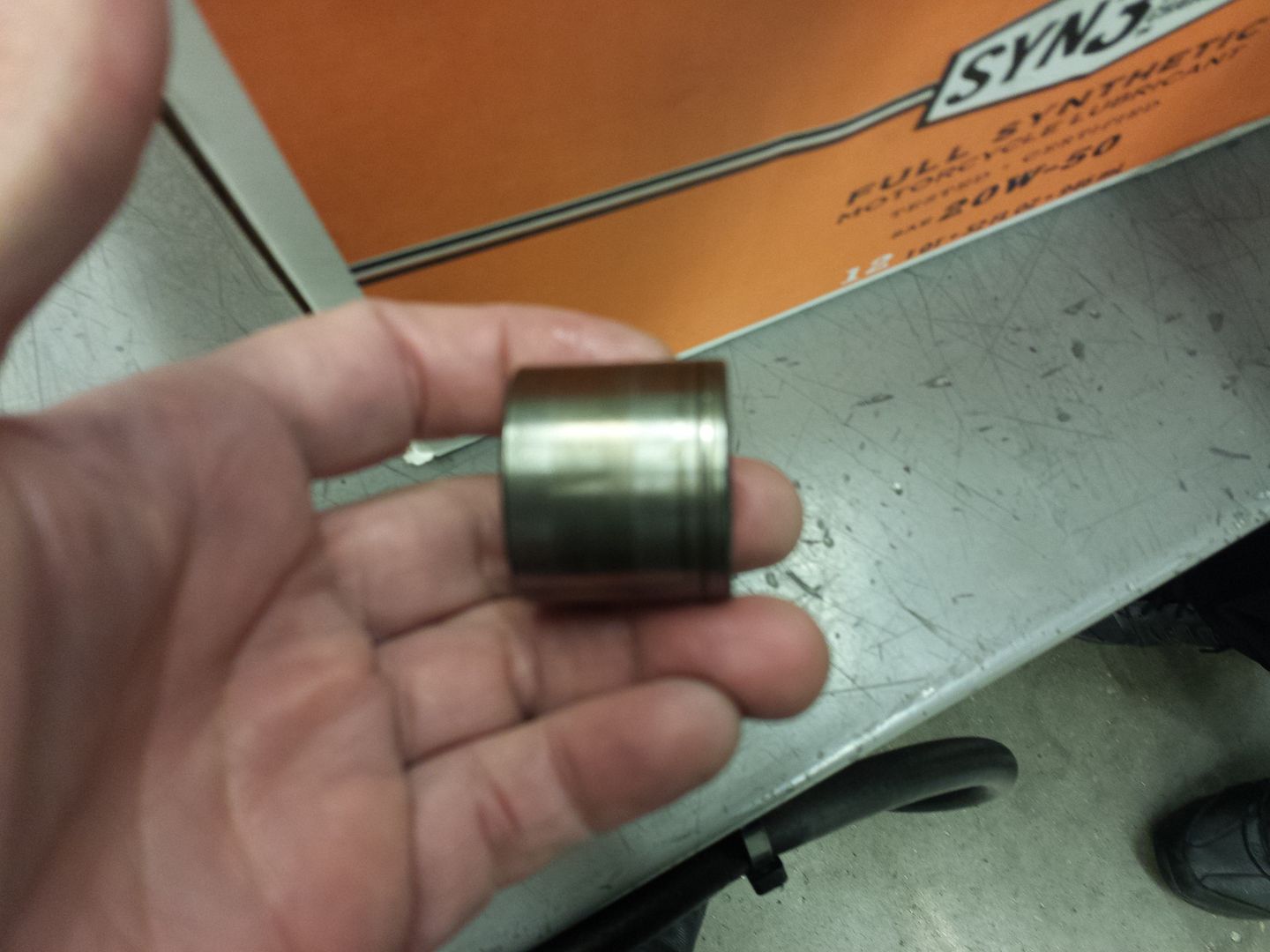

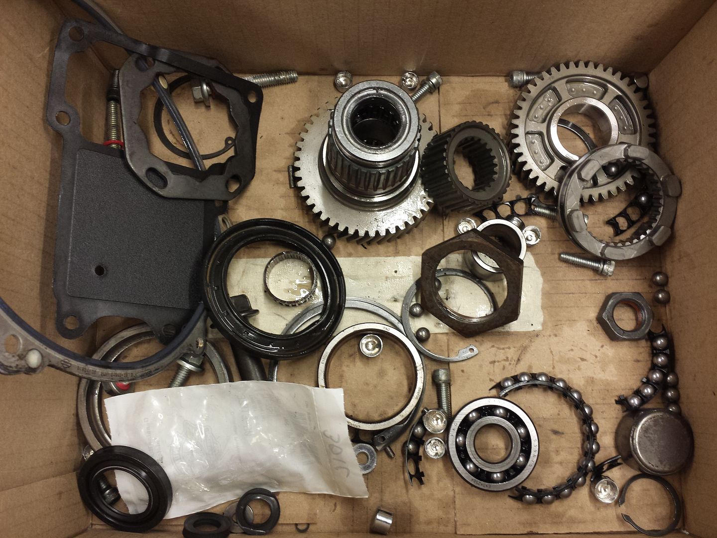

    And here are the spare parts! Bearings were all over the place and one was even GONE! You can see on the shaft how it's not smooth where the ring goes! Also the pulley, although you can see it in the picture, but they placed it on the balance machine, gave it a spin and that thing was dancing like a one legged chicken!
    All internal components are brand new again!
    Frank, what'd they suspect was the cause???
      It could have started with the pulley being warped. You could see (according to them) that the belt once tight to specs, when you look at the hole indicator it was going up and down. Possible the nagging tight...not tight....tight....not tight pulled the main shaft and the bearings busted loose.
        At least you have it fixed and back on the road.
