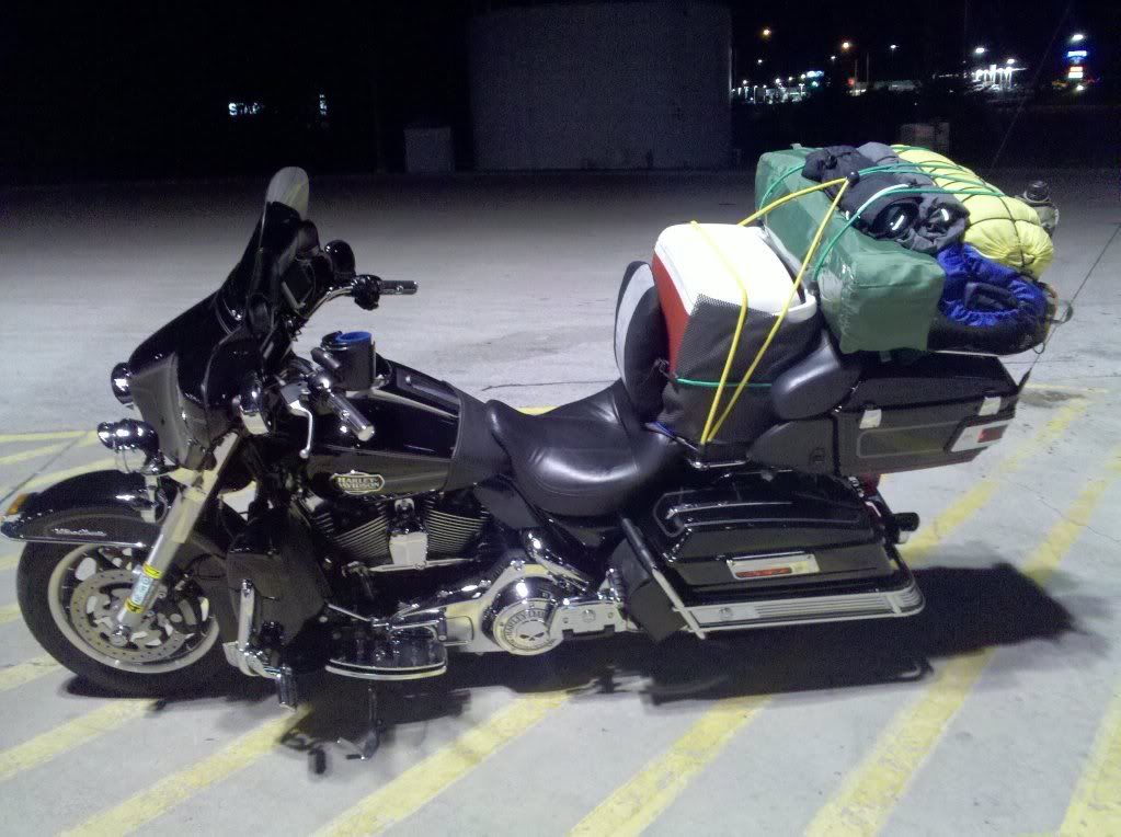

    After my last ride report it was mentioned that I should start a sticky on motorcycle camping mainly on equipment and the process of packing a motorcycle. First I would like to make it clear that I am by no means an expert on anything, but what I have I feel is more experience than the average bear on living out of doors. A lot of that experience is military, where rugged, lightweight equipment is key, and packing and loading that equipment is sometimes challenging. In concept the same applies to motorcycle camping with the need for compact, and lightweight equipment. Add to that the complexity of loading it on something that you will have to balance and maneuver, and you see the problem. Now I consider myself anal on some areas of this, but it is just the way I was taught and stuck with it. It drives my wife crazy so it also has entertainment value....

    The first and one of the most important decisions that you will make prior to hitting the road is coming up with a good "load plan." In the military load plans were a way of life that you ALWAYS followed. Every vehicle was loaded the same way, tool bags, weapons, spare ammo, first aid kits, etc... would be found in the same location on every vehicle. The main reason was, in combat if you had to go to another vehicle for ammo or anything, you knew where it was. The other reason, the one that applies to this particular topic is that you know what is on your bike, and can pack it back the same way on day 13 as when you left your house. I have mentioned before that I have seen guys show up on the first night with the bike and gear looking nice and tight, but can't get the equipment loaded back on the bike the next morning. Load plans will be different for everyone, and should be flexible enough that you can pack for hot & cold weather, and short and long trips. One example that I use is that I have a "Basic load" that is the same no matter if the trip is hot, cold, short, or long.

    It does not matter if my trip is 4 or 40 days, if I am camping or staying in a hotel that list does not change. You need to figure out what YOUR basic load will be and stick to it. Just because I choose to bring 4 pair of socks does not mean you can't have 5 in your basic load. Once you commit to what you want in your basic load, stick to it
    Now that you have a basic load that you will be using, pack it, unpack, & pack it again. See if you can figure out a way to pack it, and load it as small as possible. Space on a bike is valuable, the more space you save on basic load, the more room you have for gear for the trip.
    Basic load is just that your basic load. If you find that you are taking something with you every time you go on a run, just add it to your basic load.
    **NOTE**
    Try to avoid adding too much to your basic load. You will be adding stuff like a sleeping bag or bed roll, tent and such to your GEAR LIST which we will discuss later. I keep my basic load packed and in my spare bedroom so all I have to do is grab it and load it. If you keep you basic load B-A-S-I-C you will find that you will avoid bringing stuff that you do not need or use.

    This is a process that changes every time you finalize your gear list. Packing the void means quite simply packing items within other items. If you still don't know what I mean here is an example: Let's say you are taking a small to medium sized cooking pot with you because you will be camping on this trip. Well what items can you pack in that pot before you load it up. The pot itself is going to take up a constant space because you can't make it smaller. But you can utilize the void in the pot for other items. Items like cups, pots and other items with wasted space should be utilized to store stuff. Some of you asked or commented on me bringing a two burner stove. Well that Coleman 2 burner stove has a very big void that was packed with just about an entire field kitchen for camping. And it did not cost me any more space. The trick to void packing is to lay out all your gear, and start the process of compression packing the soft items, or looking at the hard items and filling the void with those soft items.
