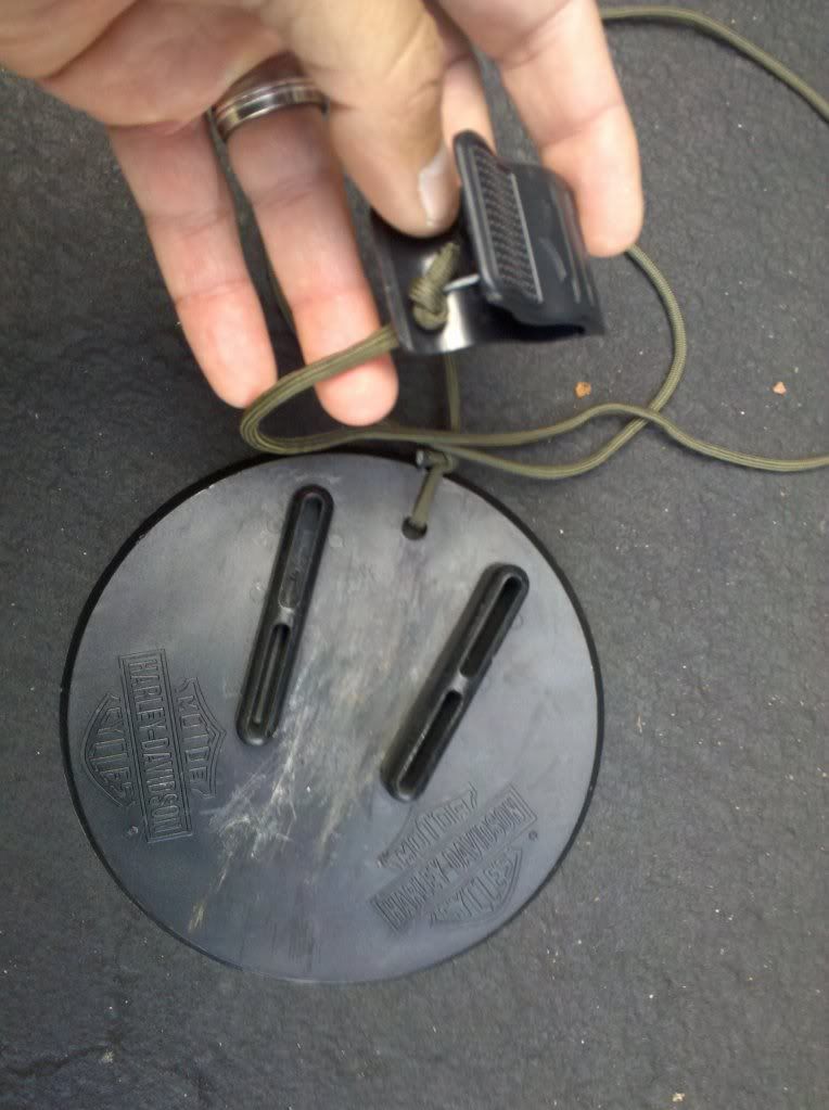

Parts needs:
Kickstand pad
Spring clip
Short length of paracord (550) or similar.
The spring clip I used came with a pair of gloves purchased at the dealer. You might stop by and see if they have any laying around that you can have.
Drill a hole in the spring clip and kickstand pad ( my pad already had the hole ), tie the clip to the pad with enough cord so it will reach to your clutch lever when you put the pad under the jiffy stand.

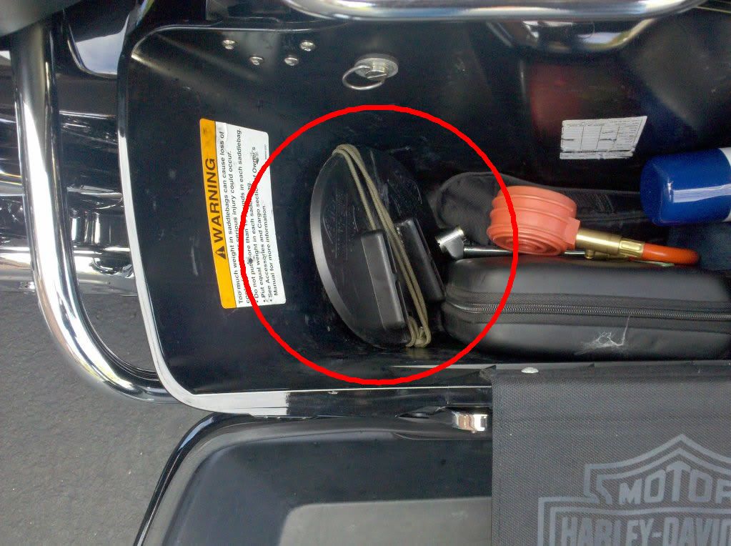

I put it in my left saddle bag where I can reach it while I am still on the bike. Then when time to leave, I can put my jiffy stand up, un-clip my clutch cable - roll it up and put it back in my saddle bag.

Finished Product.
Stored in the front of the left saddle bag.
Jiffy stand on pad, clip on clutch lever.
